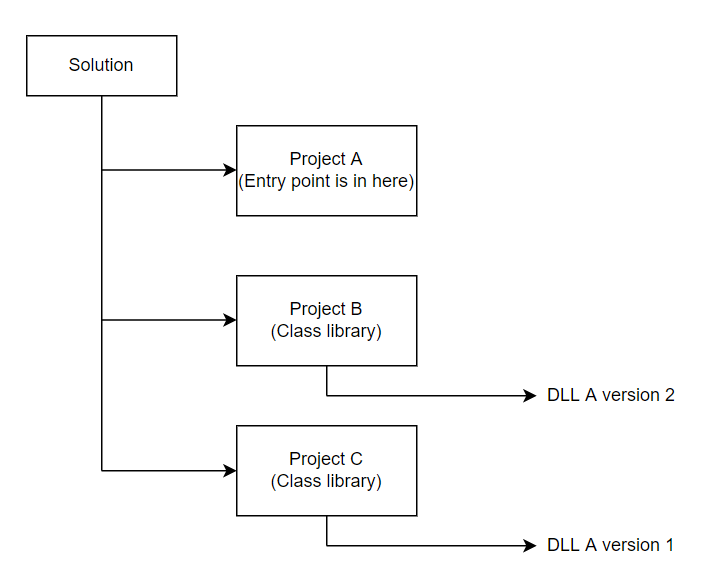

I have a solution with multiple projects. There is a need that I have to refer to a different version of the same assembly in two different projects.
When building the projects, one DLL is overwriting the other DLL, because they are both being compiled in the same folder. So the DLL that depends on the older version fails with an error.
Could not load file or assembly XXXX or one of its dependencies. The located assembly's manifest definition does not match the assembly reference.

I want to know, is there any way we can use Approach 1 and the application works correctly? I also want to know updating the same line of code in the Project A application was working correctly without any error so will that affect Project C as I am not sure Approach 2 will have any impact on Project C behavior or functionality?
Here Is there any other approach we can use to resolve the issue, where we can use the same DLL with a different version in Project B and Project C?

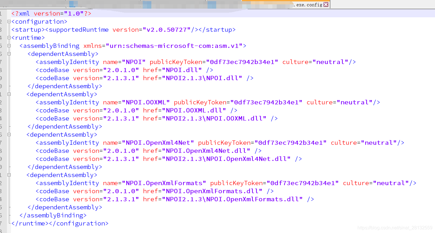

    You can try the following two methods to reference different versions of a same dll for different projects of the same solution.
    1. Add the ***.exe.config configuration file corresponding to the running program exe in the client, and configure it according to the picture.
      It’s important to note that you must write all the versions you rely on.
    2.If you reference different versions of DLLs in the same project, but the new version of the DLL is compatible with the old version of the DLL, you can use Redirecting assembly versions
