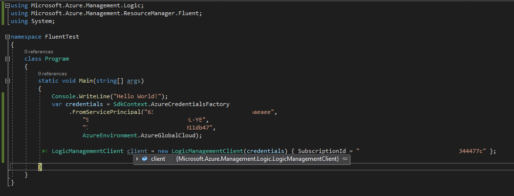

I'm trying to retrieve the Azure logic app actions' execution history using LogicManagementClient however getting 'Attempted to access an element as a type incompatible with the array.' error at below line -
LogicManagementClient client = new LogicManagementClient(credentials) { SubscriptionId = "****" };
The credentials object is created successfully and I could see the values while debugging -
var credentials = SdkContext.AzureCredentialsFactory
                .FromServicePrincipal("clientid",
                    "clientsecret",
                    "tenantid",
                    AzureEnvironment.AzureGlobalCloud);

  1. MayankBargali-MSFT 70,936 Reputation points Moderator
    2022-01-04T11:19:23.3+00:00
    @mitesh patel Can you please confirm the version for Microsoft.Azure.Management.Logic and Microsoft.Azure.Management.ResourceManager.Fluent that you are using in your project? If you are not using the latest version then I will suggest updating to the latest version and see if it helps you to resolve the issue.
    I couldn't reproduce the issue at my end and I am using the current latest version from NuGet i.e. Microsoft.Azure.Management.ResourceManager.Fluent (1.38.0) and Microsoft.Azure.Management.Logic (4.1.0).

    Thanks @MayankBargali-MSFT for your reply! Yes, I'm using latest version for both the NuGet packages. I was able to fix the issue by adding below in the app.config file in the project that was referencing the earlier mentioned code -
    <assemblyBinding xmlns="urn:schemas-microsoft-com:asm.v1">
    <dependentAssembly>
    <assemblyIdentity name="Newtonsoft.Json" publicKeyToken="30ad4fe6b2a6aeed" culture="neutral" />
    <bindingRedirect oldVersion="0.0.0.0-10.0.0.0" newVersion="10.0.0.0" />
    </dependentAssembly>
    </assemblyBinding>
