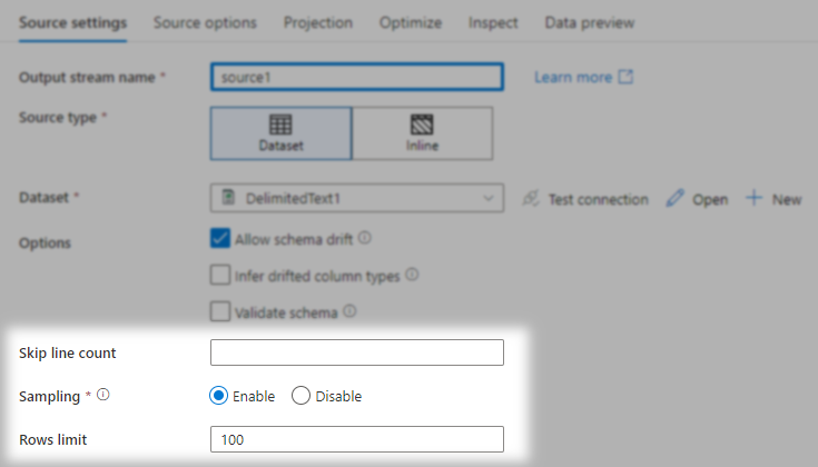

    Now you can use the index number column to join the rows. Use a dataflow for this.
    For the second file you might also want to look at using a dataflow. There you can use the "Skip line count" option to skip the first line and maybe use the "Sampling" option to only use 1 or 2 rows for sampling.
