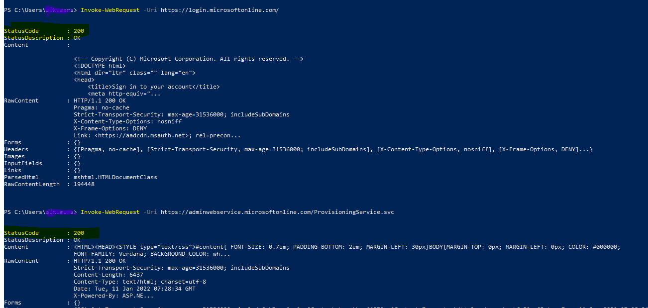

  2. Siva-kumar-selvaraj 15,721 Reputation points
    2022-01-11T07:37:09.8+00:00
    Thanks for reaching out.
    As @Manu Philip stated, this appears to be a connectivity issue; please confirm that the Azure AD Connect server has actual connectivity with the Proxy and Internet, and use PowerShell to determine if the proxy is accepting web requests or not. Run the following command in a PowerShell prompt:
    Invoke-WebRequest -Uri https://login.microsoftonline.com/
    Invoke-WebRequest -Uri https://adminwebservice.microsoftonline.com/ProvisioningService.svc
    if the proxy is correctly configured, you should get a success status:
    Hope this helps.
    Refer to the following link to lean more : https://learn.microsoft.com/en-us/azure/active-directory/hybrid/tshoot-connect-connectivity#verify-proxy-connectivity
