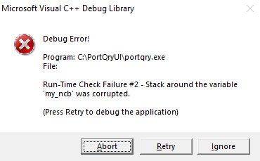

Trying to make sure all ports are open needed for AD, currently the previous admins have just had the firewall disabled for some reason. When running Port Query I'm facing some issues that are strange to me, as the ports in question show open on the firewall.
The below scan is from a DC to another DC, the two DC's are local and connected to the same switch, no network firewall all local traffic.
  • When the firewall is disabled and I run Port Query everything goes through fine as expected, no error and everything comes back as "LISTENING" (as it should).
  • When the firewall is enabled and I run Port Query I receive a debug error (screenshot/text below), prior to receiving the error the "Query Results" scans port 445 and returns:
    "TCP port 445 (microsoft-ds service): FILTERED
    portqry.exe -n criswellgbdc2 -e 445 -p TCP exits with return code 0x00000002."
    • If I click "Ignore" or "Retry" the test goes through, but then shows me more ports that it believes are closed, which are open on the DC that is being scanned.
Error screenshot(PLEASE NOTE: this doesn't come up if the firewall is disabled):
Error text(PLEASE NOTE: this doesn't come up if the firewall is disabled):
Microsoft Visual C++ Debug Library
Debug Error!
Program: C:\PortQryUI\portqry.exe
File:
Run-Time Check Failure #2 - Stack around the variable 'my_ncb' was corrupted.
(Press Retry to debug the application)
Abort Retry Ignore
Full Query Report after clicking Retry(Sensitive information removed):

    I think so. The server ports are listed here but note the clients respond on dynamic ports.
    https://learn.microsoft.com/en-us/troubleshoot/windows-server/identity/config-firewall-for-ad-domains-and-trusts#windows-server-2008-and-later-versions
3 additional answers
    2022-01-13T17:12:49.36+00:00
    You shouldn't need to make any modifications to the windows firewall. Just make sure both got the domain firewall profile.
    The Network Location Awareness (NLA) service expects to be able to enumerate the domain’s forest name to choose the right network profile for the connection. The service does this by calling DsGetDcName on the forest root name and issuing an LDAP query on UDP port 389 to a root Domain Controller. The service expects to be able to connect to the PDC in the forest domain to populate the following registry subkey:
    HKEY_LOCAL_MACHINE\Software\Microsoft\Windows NT\CurrentVersion\NetworkList\Nla\Cache\IntranetForests
    If something hinders the DNS name resolution or the connection attempt to the DC, NLA is not able to set the appropriate network profile on the connection.
    https://learn.microsoft.com/en-us/troubleshoot/windows-server/windows-security/computer-cant-identify-network
    So I'd check the domain controller and problem client have the static address of DC listed for DNS and no others such as router or public DNS
    2022-01-13T18:16:57.023+00:00
    As long as the domain controller has the domain firewall profile then all required ports will be available.
    2022-01-13T18:55:24.613+00:00
    There's no need to do anything with the unused firewall profiles since they are in fact not being used. As to 138, 139, 445 you can turn on File and Printer sharing
