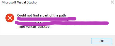

    • Visual Studio 2015
    • Vulkan 1.2.182.0 (if you use the latest Vulkan then it will be failed to compile).
    Note:
    • I leave the "build" folder by "CMakeLists.txt" because it's one of the hardest to fix if missing system files happen, I just deleted the big files in it.
    Screenshot
