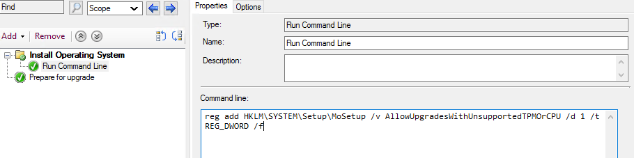

    We could add the command line before the step of prepare for upgrade, please refer to the following screenshot:
    And after deploying, the value has been changed.
    About add it in my TS a Registry entry, refer to the article:
    https://msitpros.com/?p=1031
    Note: Non-Microsoft link, just for the reference.

  2. PerserPolis-1732 1,971 Reputation points
    2022-01-17T08:06:06.197+00:00
    Hi
    I can upgrade windows 11 without sccm.
    I can guess it is the by checking the hardware from windows 11. Could you tell me please how I can add in my TS a Registry entry?
    the following entry
    in the "HKEY_LOCAL_MACHINE\SYSTEM\Setup\MoSetup"
    add a "DWORD 32 Value"
    Named: "AllowUpgradesWithUnsupportedTPMOrCPU"
    With the entry I can pass the CPU check of from Windows 11
    Thanks
