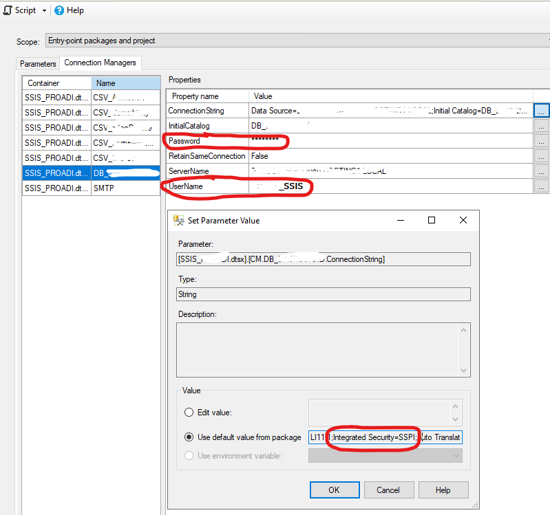

today it was necessary to create a proxy account to run an SSIS package.
It was working, after removing the SSIS package and deloying the SSIS package again it works manually, but when we try to schedule the SQL Agent JOB it fails. After configuring the proxy account it worked successfully.
PS: Integration services is on server B and the database that the SSIS package works on is on server A. That is, the credentials I use within the connection string are from server A.
I honestly don't understand why I need to enter a username and password in the string configuration, if my connection string has an option of (Integrated Security=SSPI). ]:(
Error:
An OLE DB record is available. Source: "Microsoft SQL Server Native Client 11.0" Hresult: 0x80040E4D Description: "Login failed for user 'domain\hostname$'.".
String connection:
Data Source=hostname.domain;Initial Catalog=DB_Samples;Provider=SQLNCLI11.1;Integrated Security=SSPI;Auto Translate=False;
We have other SSIS packages that are using SQL Agent without proxy, using the same project settings (EncryptSensitiveWithUserKey).
In the procedures that we found says to create the proxy account mapped with the user (SA), however we were concerned about the security risk that this can generate for the environment.
