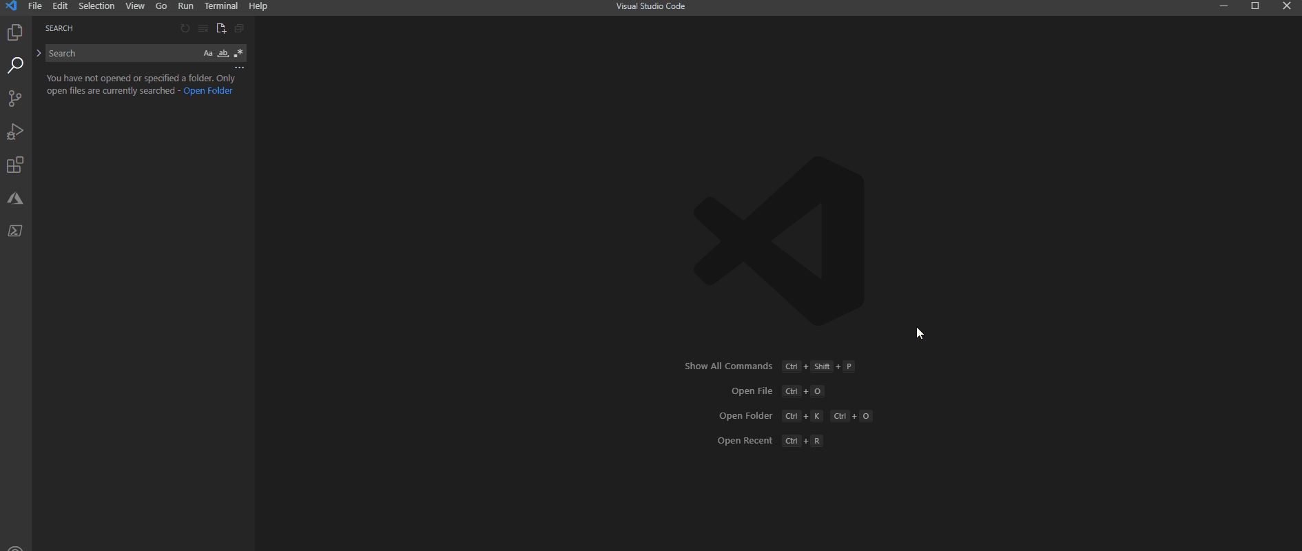

This is the error that I get when I click on "Sign in to Azure" from the Azure Functions extension in VS Code. This is not a step that is covered in the documentation (even in the pre-requisites) for creating an Azure Function. How do I resolve this? It is for all accounts, and it appears to be a missing step in the documentation. Creating a new Azure account does not solve this issue.

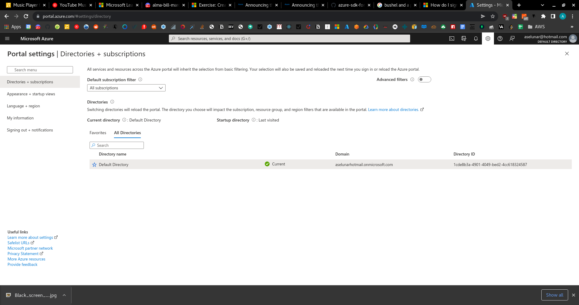

    As per the error what I can guess is, the VS code is trying to access the application which does not exist in your Learn Sandbox directory.
    Could you try changing your Directory as mentioned below?
