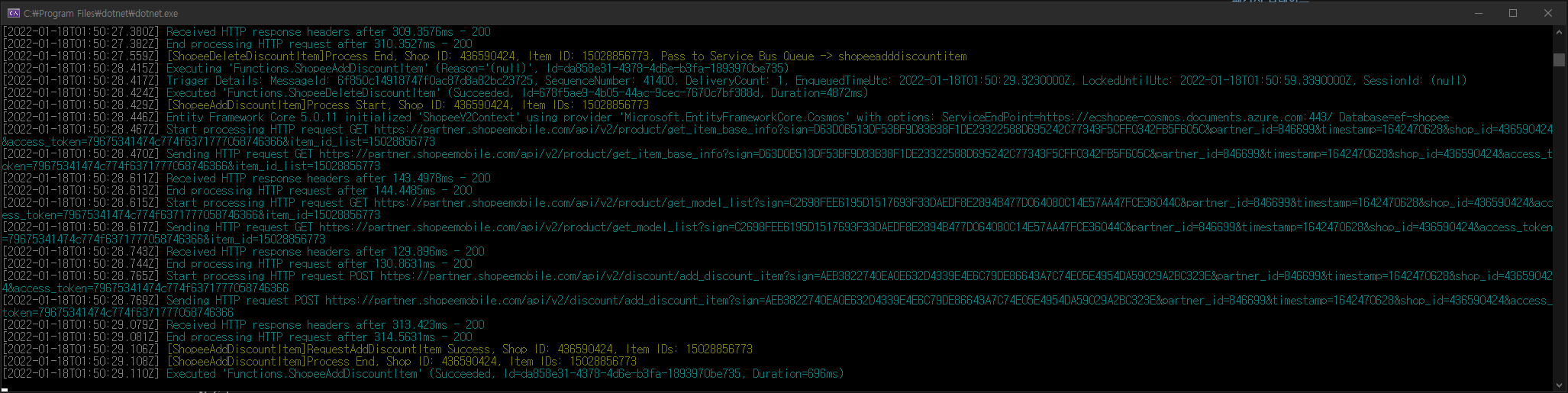

I'm using Azure Functions v3 with .NET.
HTTP communication occurs when certain Azure ServiceBus Triggers process messages.
The problem is, if logLevel is set to Information in host.json, when I record at Information level through the Logger received through FunctionContext.GetLogger("FunctionName"), even HTTP logs are output to the console window, making it difficult to distinguish them.
If I set logLevel to Warning as a trick, the HTTP log is not output because it is at the Information level, and I can record the log as Warning level through the Logger.
It is not an expedient like the above method, but I would like to record only the contents I record with the code as information and not record the other logs.
Is there any way to solve this?

    From the loglevel perspective, we have multiple options but "information" is the closest that you can get to log the flow of your function. There are other configurations however they will either get removed or add more information which will add complexity
    Configure log levels: https://learn.microsoft.com/en-us/azure/azure-functions/configure-monitoring?tabs=v2#configure-log-levels
    The best approach is using Application insights where you can record only specific contents and set the sampling settings as mentioned in the following article.
    https://learn.microsoft.com/en-us/azure/azure-monitor/app/ilogger
    https://learn.microsoft.com/en-us/azure/azure-functions/configure-monitoring?tabs=v2#configure-sampling
