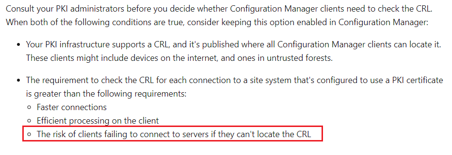

    I proceeded as suggested above and deactivated the CRL checking in IIS. This, sadly, did not change anything. I also deactivated CRL checking in ConfigMgr, with the same result. When copying the CRLs from the certs and manually trying to reach them, everything is fine - Edge offers the CRL as a download. Also checked CRL validity, which is ok.
    I checked the Client Certificate and the Server Certificate again and could not find anything out of the ordinary - V3, SHA256, RSA (2048), Subject, Subject Alternative Name, CRLs - it's all there. Yet the Server Cert seems to be the one causing issues:
