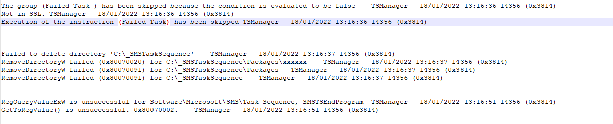

hi, I have TS to copy and run some script. In the smsts log I can see everything is working but it still show as failed, If I re-run the TS few times then it show as successful.
I already delete development and also the TS and recreated but same issue.
The only errors i see in the smsts log are
At the end I have a task to fail to TS if any of the data is missing but you can see that, that group is being skip as it doesnt meet the criteria

    Without knowing the steps in your TS, it will be difficult to troubleshoot. Can you provide details on your setup? Perhaps share screenshots and the complete smsts.log?

    The issue was that I was using ASAP on the development which cause the TS to failed as policy was still not pply to machine. After check the dead line date to today's date it fix the issue.
