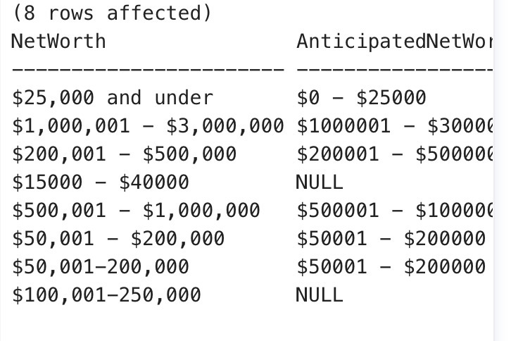

From the above tables need the below Results :

  1. LiHong-MSFT 10,056 Reputation points
    2022-01-19T07:41:04.377+00:00
    Hi,@Vivaan
    Please check this:
    ;WITH CTE1 AS
     SELECT NetWorth,
            CASE WHEN CHARINDEX ('and under', NetWorth) = 0
                 THEN REPLACE (NetWorth,',', '')
    			 ELSE '$0-$25000'
    			 END AS ModifiedNetWorth
     FROM #Networth
    CTE2 AS(SELECT NetWorth, REPLACE (ModifiedNetWorth,' ','') ModifiedNetWorth FROM CTE1  ),
    CTE3 AS(SELECT NetWorth, REPLACE (ModifiedNetWorth,'$','') ModifiedNetWorth FROM CTE2  ),
    CTE4 AS
     SELECT '$'+CAST(MinRange AS VARCHAR)+' - '+'$'+CAST(MaxRange AS VARCHAR) AS AnticipatedNetWorth
             ,CAST(MinRange AS VARCHAR)+' - '+ CAST(MaxRange AS VARCHAR) AS RangeNetWorth
     FROM #NetWorthAnticipated
    SELECT NetWorth,AnticipatedNetWorth
    FROM CTE3 A LEFT JOIN CTE4 B
    ON LEFT(ModifiedNetWorth,CHARINDEX ('-', ModifiedNetWorth)-1) =LEFT(RangeNetWorth,CHARINDEX ('-', RangeNetWorth)-2 )
    OR RIGHT(ModifiedNetWorth,CHARINDEX ('-', ModifiedNetWorth)-1 ) =RIGHT(RangeNetWorth,CHARINDEX ('-', RangeNetWorth)-2 )
    Output:
    Best regards,
    LiHong
    Note: Please follow the steps in our Documentation to enable e-mail notifications if you want to receive the related email notification for this thread.
