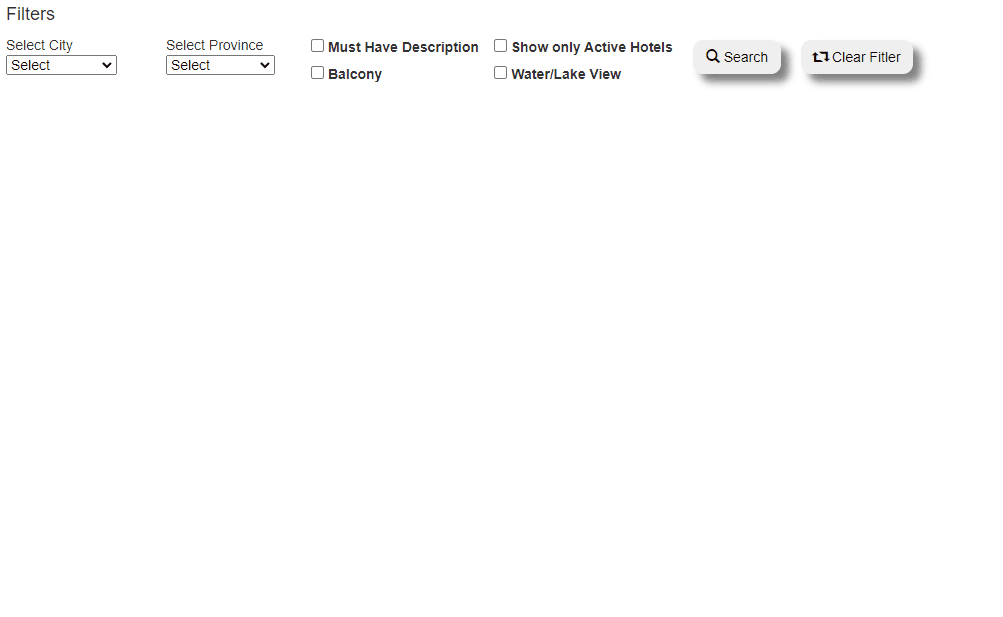

    So, say I have this filter - just plain jane markup:
    Now, if you look closely, I have 6 possible choices (6! = 720 possible combinations).
    (and love that you introduced n! (factorial) here - reminds me of high school math)
    However, the trick is to keep in mind that the choices are cumulative!
    Thus, all we have to do is write our filter code to "add" each control if filter, or ignore.
    So, we can rather easy build up a filter (sql where clause).
    the 2nd VERY important issue is we STILL need to use SQL parameters (no sql injection allowed - right!!!).
    so, the way the filter code looks is like this:
    Now, for the check boxes, we actually don't need SQL paramters. And I don't have any input text box, but for safety, the follow code shows I can BOTH add SQL parmaters on the fly and also direct sql condiations (for when I don't need a paramter).
    Most don't realize that the Sqlcommnd allows you to add parmaters, and it DOES NOT care about the SQL it has (yet!!!).
    So, the code looks like this. We can have 2, or 20 filters. All you do is just keep on appending/adding to the where clause string.
    And for any case to avoid sql injeciton then simple add/use a @ paramter.
    So, the code looks like this:

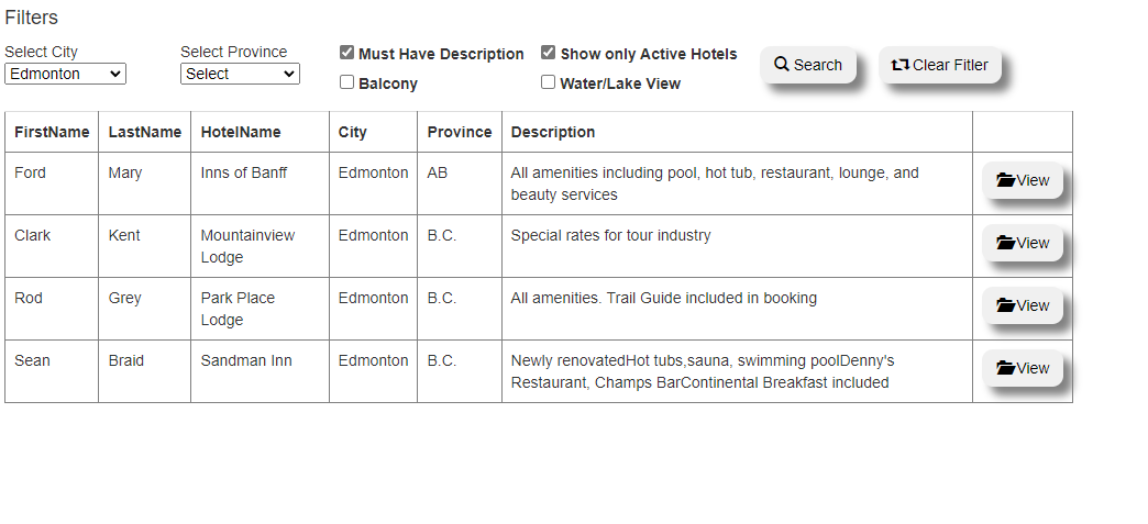

    And that is quite much it.
    The results thus look like this:
