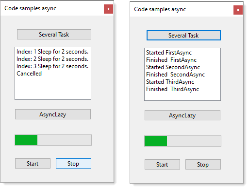

  2. Karen Payne MVP 35,586 Reputation points Volunteer Moderator
    2022-01-20T14:52:52.017+00:00
    Check out several code samples in this project.
    Each code sample is the project are easy to follow but the code spans forms and classes such as in real life rather than have all code in a Windows Form, a WPF Window etc,
    Execution is in this form
    Classes used
    Screenshots
