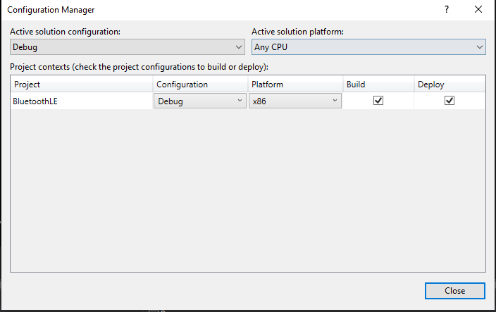

I DOWNLOADED THE BLUETOOTH LE EXAMPLE. EVERYTHING COMPILED BUT I AM ABLE TO RUN IT. I AM NOT GETTING ANY ERROR. IT JUST DON'T DO ANYTHING. IT WOULD NOT EVEN START IF I AM RUNNING IT IN DEBUG MODE

    I went here to get the sample and had the same problem. Click Build -> Configuration Manager. Check Build and Deploy. Now you should be able to run the project.
