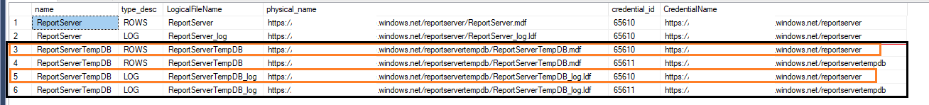

Problem exists in sys.master_files table for ReportServerTempDB where server wrote 2 rows per each file, both rows are identical except in credential_id field:

    You would have to drop or rename one of the credentials. I ran:
    EXEC  sp_helptext 'sys.master_files'
    and I found this join:
    FROM sys.sysbrickfiles$ f
    LEFT JOIN sys.syspalvalues st ON st.class = 'DBFS' AND st.value = f.filestate
    LEFT JOIN sys.syspalvalues ft ON ft.class = 'DBFT' AND ft.value = f.filetype
    LEFT JOIN sys.credentials cr ON f.pname LIKE cr.name + N'%' COLLATE database_default
    f.pname is the value in the phyiscal_name column. Because of the LIKE operation, the name matches both the reportserver and reportservertempdb credentials, and whence the join produces two rows.
    I will have to admit that I find this join a little iffy.
