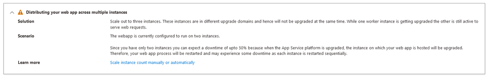

On the Azure portal for our app service, we've recently seen a recommendation to scale out to 3 instances (we're currently running 2 as minimum + autoscale rules). However, we're not able to find any official documentation on how app service instances are getting distributed and how that would prevent any downtime. The recommendation also states that "since you have only two instances you can expect a downtime of upto 50% when the App Service platform is upgraded".

    Hi @Gintaras Bubelevicius . Thank you for your question and sharing the screenshot to help us easily understand the request.
