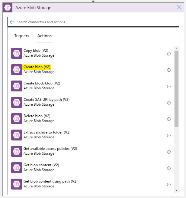

    @MayankBargali-MSFT It has been turned on as below:
    The Runtime.FlowRunActionJob.MaximumActionResultSize only helped with HTTP action to extract data file exceeding 100 MB, but won't help Create blob (V2) action to save a file exceeding 100 MB in the data lake as below:
    I have run 2 files this time, 1 MB (succeeded) and 180 MB (failed) ad below:
