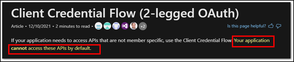

    By looking at the error message, it indicates that your application didn't have the ability to use LinkedIn's client credentials flow to get the access token. Even from below highlighted statement from public document, my understanding is that Your application cannot access the APIs by default. You may have to reach out to Linkedin support to get the permissions to use client credentials flow for accessing the APIs.
