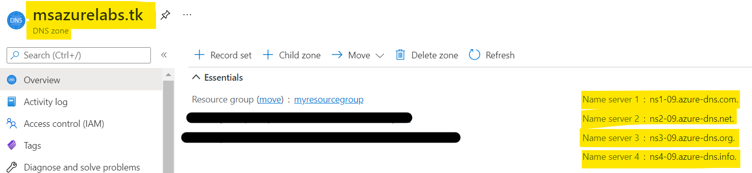

    I have a domain "msazurelabs.tk" in a DNS registrar and so I created the same domain in Azure delegated this domain to Azure DNS as below:
    Azure DNS zone (Parent zone):
    Added Azure DNS NS records to registrar:

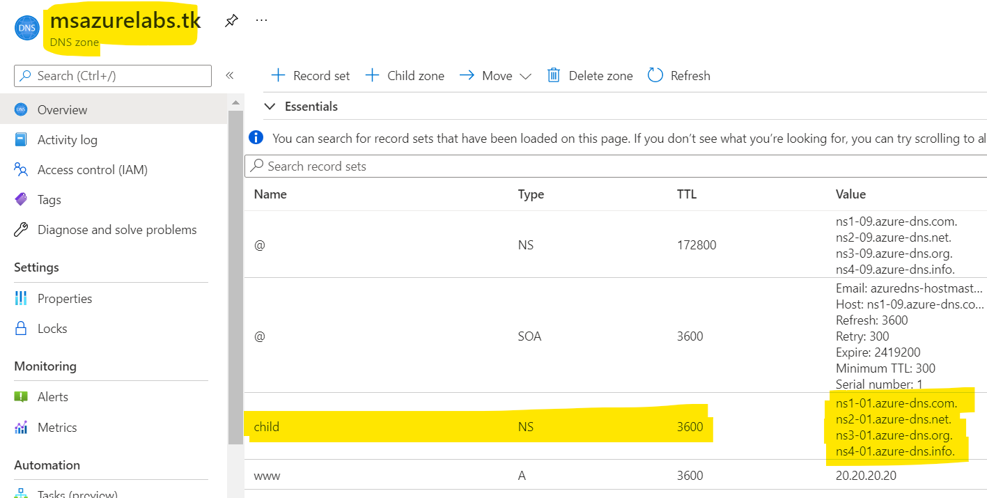

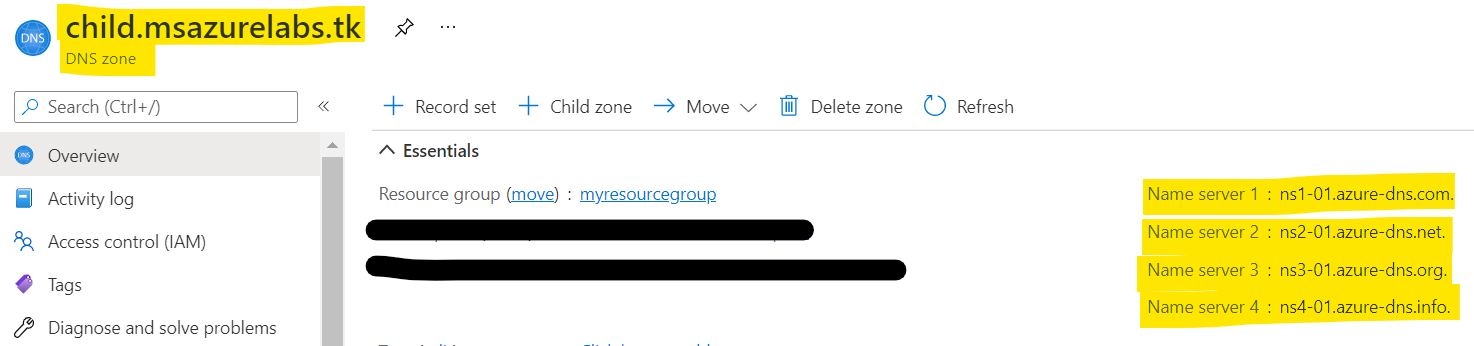

    Now, I have created a child zone "child.msazurelabs.tk" in Azure under "msazurelabs.tk" and you can see it's NS records are already updated in the parent zone:
    Child zone in Azure DNS:
    Nameservers of child zone updated in parent zone as a NS record:
