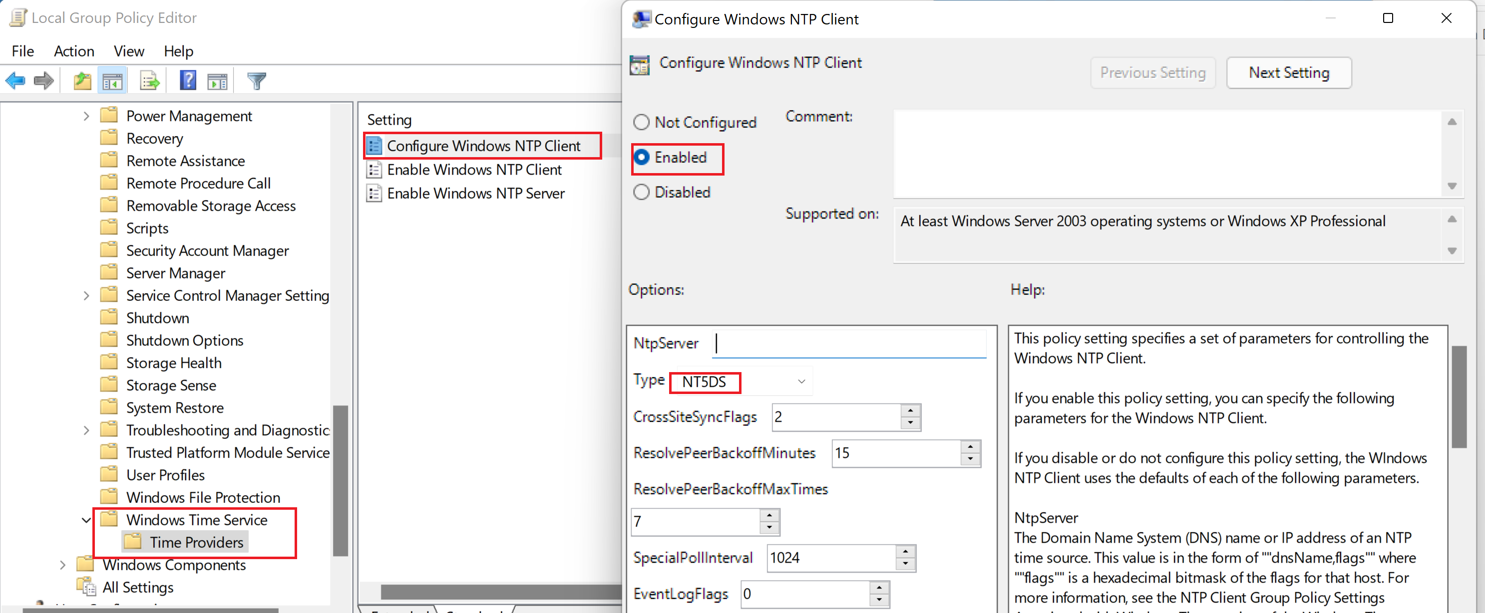

    How to change the Type for NTP to NT5DS for all connected servers / workstations
    You could create a policy that applies to the OU for the computers that sets NT5DS
