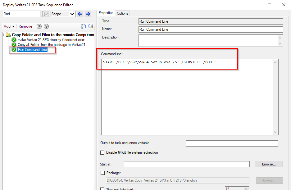

I have a question about run command in the TS. I wanna to run a command line like
Setup.exe /S: /SERVICE: /BOOT:
The file exe is located on the following directory
C:\SSR\SSR64
How can I run that command line "Setup.exe /S: /SERVICE: /BOOT: " in TS?
any Idea?

    You may specify the path "C:\SSR\SSR64" in "Start in":
    And note, SCCM excute the command line with system account, we may test it manually with PsExec.

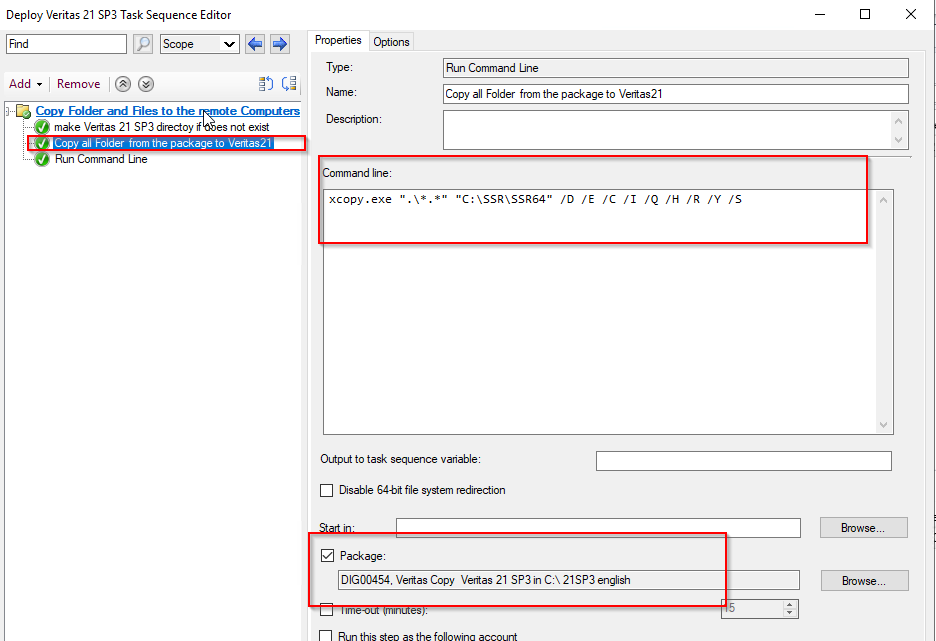

    here my steps
    If run the command line Setup.exe /S: /SERVICE: /BOOT: manually, it is working
    in the smsts log file
    The execution of the group (Copy Folder and Files to the remote Computers) has failed and the execution has been aborted. An action failed. Error 0x80004004Showing task sequence error message after failure in task sequence step of type 'SMS_TaskSequence_RunCommandLineAction'
    Task Sequence Engine failed! Code: enExecutionFail
    Task sequence execution failed with error code 80004005
    Error executing Task Sequence Manager service. Code 0x80004005
