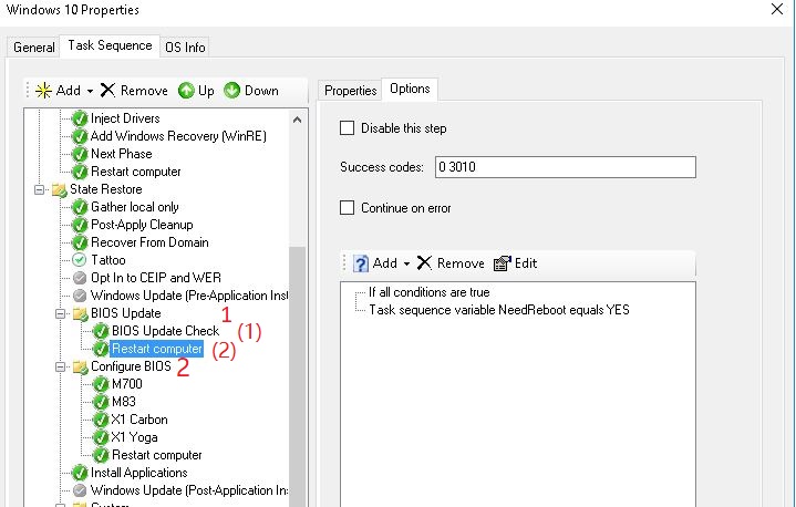

    Thank you for the valuable input. Yes, we are talking about the same thing. Please understand that we don't have the exact environment for testing. Guess the script is for task (1), right?
    From line 29 to line 32, if the version match, the Restart Computer (2) task will be skipped (since NeedReboot isn't set to YES) and the TS will move to next group Configure BIOS 2.
    And the suituation is: the Restart Computer (2) task was not skipped, right? So, we suggest to track when the variable NeedReboot is changed (as mentioned above). The short eight-line cmdlets are just to manually test to see if the logic is correct. If possible, you may test in your environment and share the result.

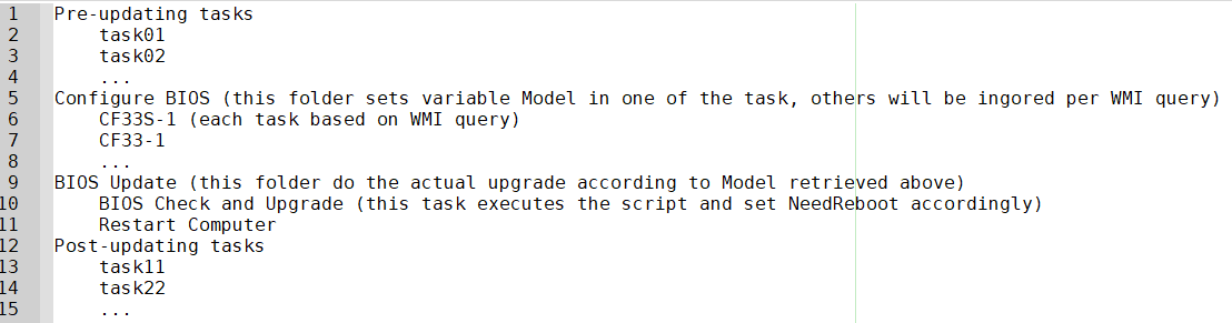

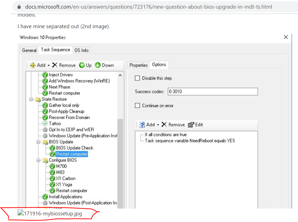

    I have read through both the two threads for several times. It seems we missed the actual screenshots (not shown correctly) and script in the actual environment. I suppose the right structure of TS is as below:
    Note: (1) the folder only groups the tasks and it never do the selection so we encounter multiple reboots currently
    (2) please change the TS as listed above and try again, if any problem is encountered, please share the script in BIOS Check and Upgrade task for further debugging.
    not shown correctly image
