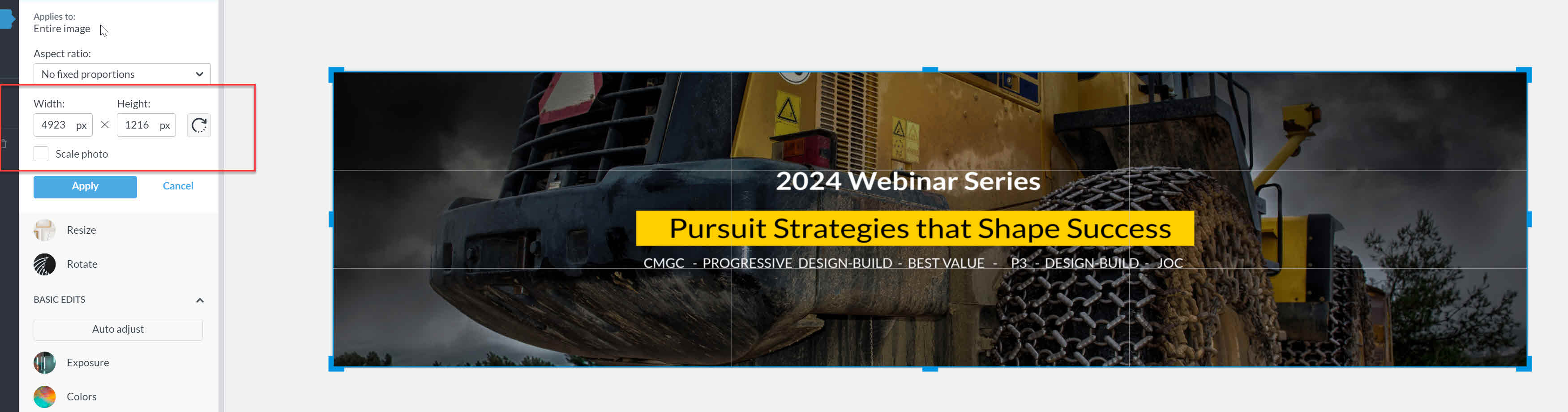

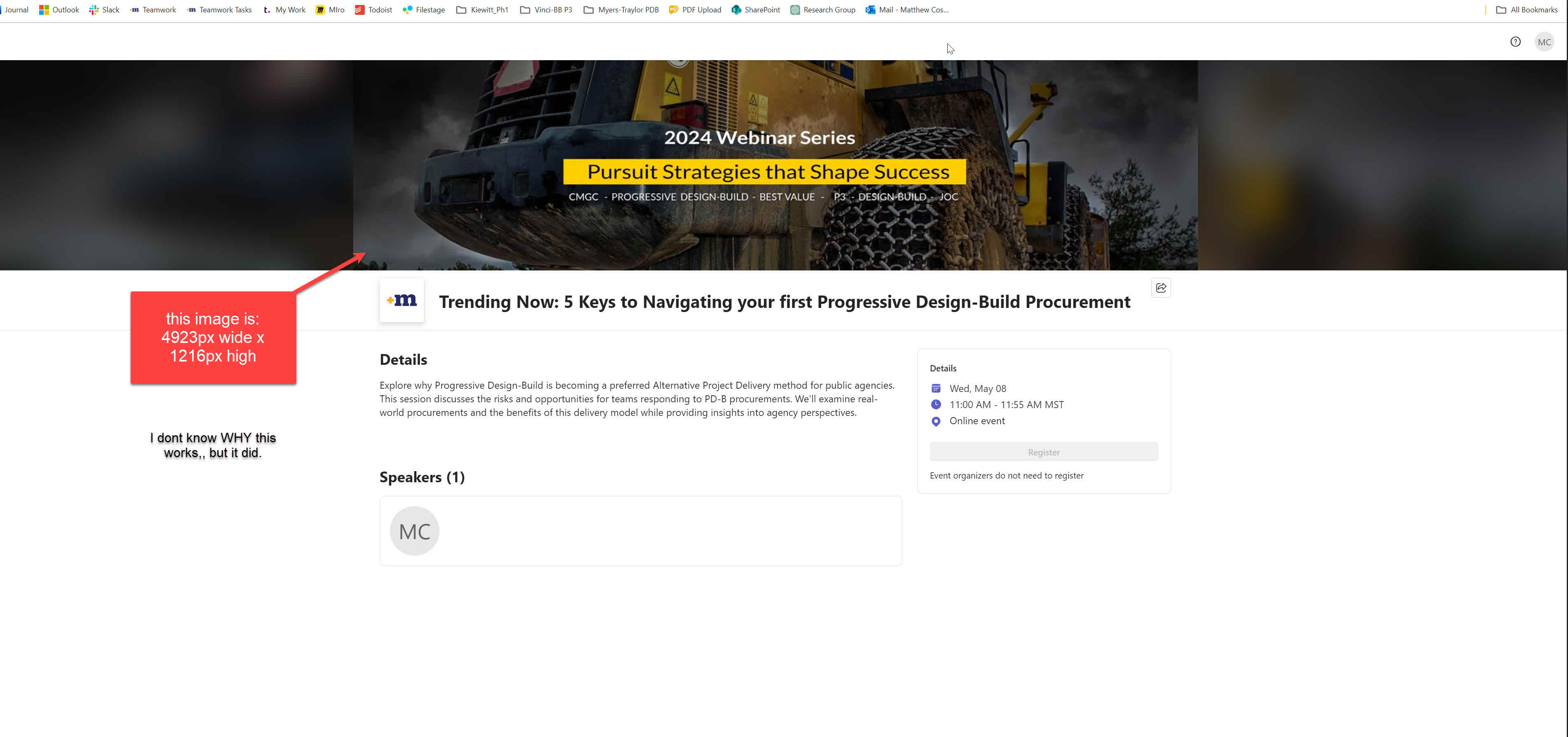

2024-04-17T04:23:10.0533333+00:00 I know this is an older post, but my team worked through every iteration of images we could think of until.... 4923px x 1216px as a .png file worked perfectly.
Here is the exact image size in PicMonkey
Here is the same image in the Microsoft Teams Webinar page - not blurry!!
I hope this works for someone else! Good luck!
