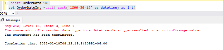

    I guess I never did say what I was doing with it! I'm adding a column, and making an existing date into integer.
    alter table OrderData_SN
    add OrderDataInt  as datediff(day, cast('1899-30-12' as datetime), cast(OrderDate as datetime))
    I do this, it makes the column without errors, but doesnt give it a data type.
    I could make the column first, but then its like datediff() is different in the context of an update. No idea what it wants.
    add OrderDate INT
    That works fine, but this doesnt:
    update OrderData_SN
    set OrderDateInt = datediff(day, cast('1899-30-12' as datetime), cast(OrderDate as datetime))
    OrderData is in date format, hence the change to datetime.
    It tells me:
    Msg 242, Level 16, State 3, Line 1
    The conversion of a varchar data type to a datetime data type resulted in an out-of-range value.
    The statement has been terminated.
    where is the varchar data type???
    Maybe I'm wrong here, @Viorel , but when I pull out just the date text conversion, perhaps this is where the problem is. Your statement provides the proper logic, but how do you get that text in a datetime for the datediff()?
