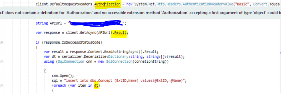

            try
                string connetionString = null;
                string sql = null;
                var serializer = new JavaScriptSerializer();
                string serviceUrl = "APIURL";
            HttpClient client = new HttpClient();
            client.BaseAddress = new Uri(serviceUrl);
            var byteArray = Encoding.ASCII.GetBytes("UserName:Password");
            client.DefaultRequestHeaders.Authorization = new System.Net.Http.Headers.AuthenticationHeaderValue("Basic", Convert.ToBase64String(byteArray));
            connetionString = "Data Source=ServerName;Initial Catalog=DatabaseName; Trusted_Connection=True;";
            string APIUrl = "/controllers/vertx/hotschedules/getConcepts";
            var response = client.GetAsync(APIUrl).Result;
            if (response.IsSuccessStatusCode)
                var result = response.Content.ReadAsStringAsync().Result;
                    var dt = serializer.Deserialize<Dictionary<string,
                      string>[]>(result);
                    using (SqlConnection cnn = new SqlConnection(connetionString))
                        cnn.Open();
                        sql = "insert into dbo.Concept (ExtID,Name) values(@ExtID, @Name)";
                        foreach (var item in dt)
                            using (SqlCommand cmd = new SqlCommand(sql, cnn))
                                cmd.Parameters.Add("@ExtID", SqlDbType.NVarChar).Value = item["extId"].ToString();
                                cmd.Parameters.Add("@Name", SqlDbType.NVarChar).Value = item["name"].ToString();
                                int rowsAdded = cmd.ExecuteNonQuery();
                        cnn.Close();
                    Dts.TaskResult = (int)ScriptResults.Success;
                //Dts.TaskResult = (int)ScriptResults.Success;
            catch (Exception ex)
                Dts.Events.FireError(0, "Fire Error", "An error occurred: " + ex.Message.ToString(), "", 0);
                Dts.TaskResult = (int)ScriptResults.Failure;
