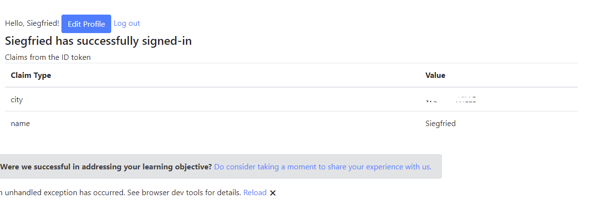

So when I sign in, I get the SUSI page I defined in the azure portal (where I can successfully authenticate) but then I get this crummy display:
Crummy display
It says "An unhandled exception as occurred. See devtools for details .... reload". Reloading has no affect. I cannot find any exception error or stack trace anywhere including the server log or the Edge dev tools after reproducing the problem.

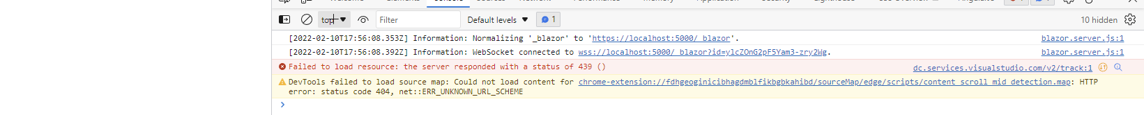

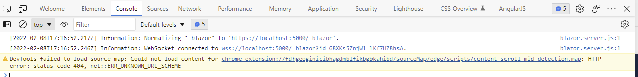

Here is edge dev tools for console where I was hoping to see the exception:

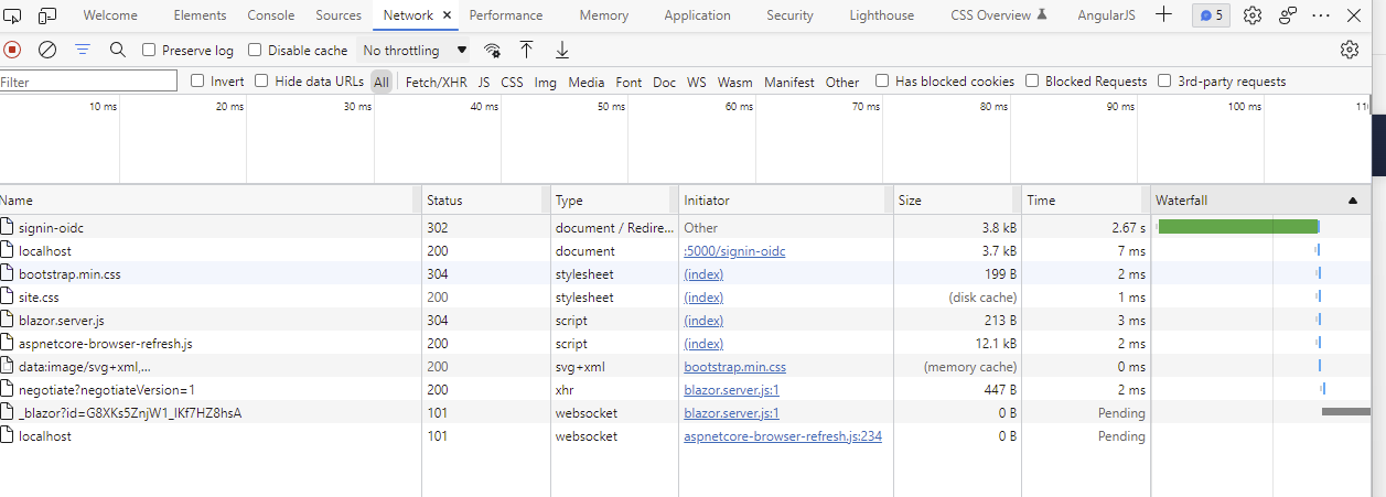

Looks like all the files loaded successfully:

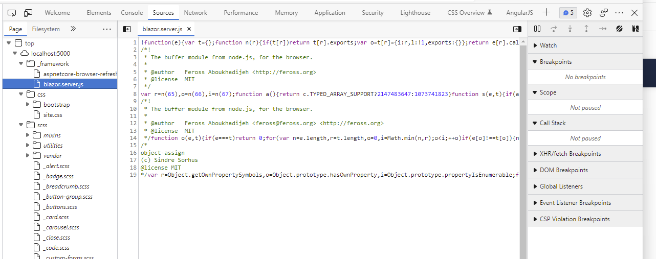

Looks like it is finding the source code:

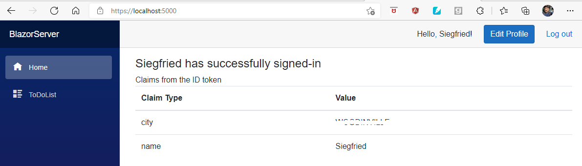

I originally developed this on my new Lenovo notebook with 32GB running Windows 11. I copied the visual studio solution directory to my 5 or 6 year old HP Envy with REALLY SLOW spinney disks and 16 GB of memory running Windows 10 and it displays properly:

OK, it was working with IIS on the lenovo and now it is not working (but that bad formatting is still working on the lenovo) but I got a new clue. We cannot connect to the websocket.
