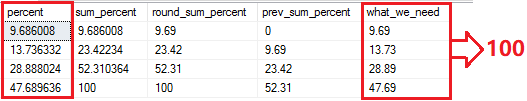

    Hi @db042190
    Maybe we can hold a running (non-integer) position and rounds the value, then uses that with history to determine what value should be used.
    Here is an sample ,please have a check:
    create table #test([percent] float )
    insert into #test values(13.736332),(47.689636),(9.686008),(28.888024)
    ;WITH CTE AS
     SELECT [percent],SUM([percent])OVER(ORDER BY [percent] ROWS BETWEEN UNBOUNDED PRECEDING AND CURRENT ROW)AS sum_percent,
            ROUND(SUM([percent])OVER(ORDER BY [percent] ROWS BETWEEN UNBOUNDED PRECEDING AND CURRENT ROW),2) AS round_sum_percent
     FROM #test
    SELECT [percent],sum_percent,round_sum_percent,LAG(round_sum_percent,1,0)OVER(ORDER BY [percent])AS prev_sum_percent,
           round_sum_percent-LAG(round_sum_percent,1,0)OVER(ORDER BY [percent])AS what_we_need
    FROM CTE
    In this way, you don't round the percentage itself. Instead, you round up the cumulative value and calculate the best integer to reach that value from the previous baseline - which is the cumulative value (rounded up) from the previous row.
    This works because you don't lose information at each stage, but use it more intelligently.
    The "correct" rounded values are in the last column and you can see that they sum to 100.
    Output:
