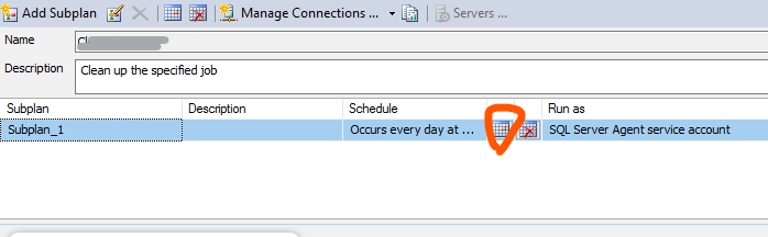

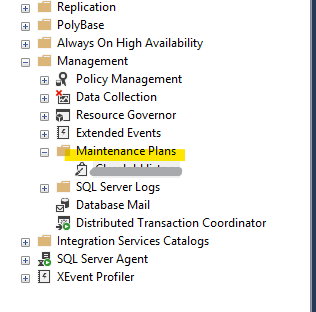

  3. Seeya Xi-MSFT 16,671 Reputation points
    2022-02-10T07:40:31.387+00:00
    Hi @RogerSchlueter-7899 ,
    Welcome to Microsoft Q&A!
    SQL Server appears to automatically back up a database whenever a change is made to the schema or to the data itself.
    Please follow my screenshots to check if you have a backup maintain plan.
    Then right click Modify,
    You can get the details about the backup plan.
