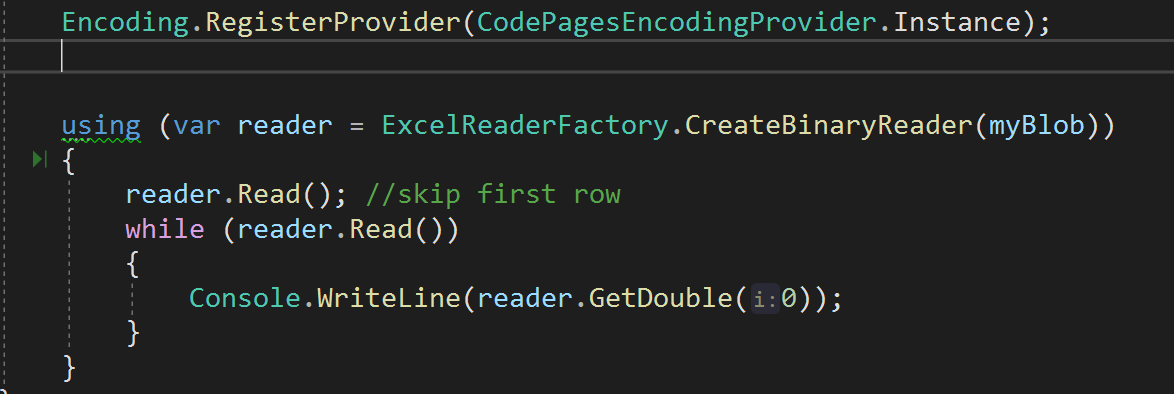

I'm rewriting an old Winforms app that processes .XLS files with ExcelDataReader as a new Azure function fired by a blob trigger.
The old code basically allowed the user to browse for a file, opened as a FileStream object then read the spreadsheet using ExcelReaderFactory.CreateBinaryReader.
In the new Azure function / blob trigger the Run() method accepts a Stream, which ExcelReaderFactory (I thought) would handle, however I get an error.
*System.NotSupportedException: 'No data is available for encoding 1252. For information on defining a custom encoding, see the documentation for the Encoding.RegisterProvider method.'*
I have added the NuGet System.Text.Encoding.CodePages package but cant seem to add a the correct "using" statement.
So I was wondering how to handle a Stream for use by ExcelDataReader. Would I convert to a CloudBlob but then I need it as a Stream (or derived type)?
Also, I will need to do some blob manipulation later in my code, mainly renaming. Will I need to cast my stream as a CloudBlob to do this manipulation.
