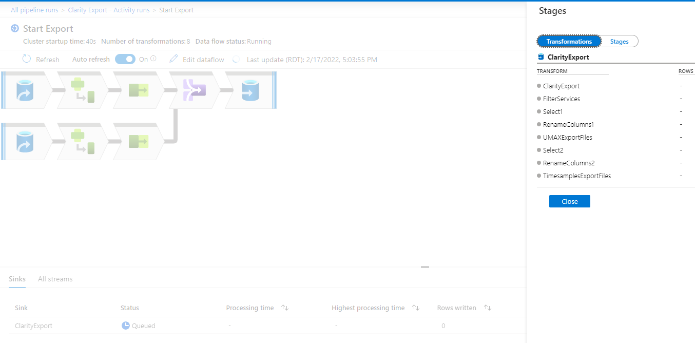

I created a dataflow with parameters that does execute properly when tested with the "Data Preview" button.
However, when I use this dataflow inside a pipeline it remains in queued stage forever.
I double checked the parameters that are passed, they seam correct.
The run id of the actvity is 849e7c59-8233-4b01-8ddf-318298b753e8
How can be troubleshoot this kind of error?

    Hello and welcome to Microsoft Q&A @Sven Peeters .
    If I understand correctly, your dataflow previews fine, but when you try to pipeline it, gets stuck in queued state. Can you tell me a few more details?
    • was it the first activity in the pipeline? If not, did earlier activities complete?
    • how long was it in queued state? 5 minutes? 1 hour?
    • Did it finish acquiring compute?
    There is a significant chance I will have to pass this off to support where they can do a deeper investigation than I can here.

    This has been solved now by support, appearantly needed 8+8 cores if you include a merge operation in your data flow
