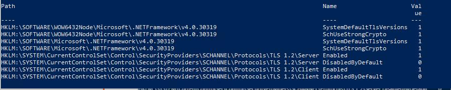

    This seems to be more on SSL/TLS communication related issue as I could see following exception repeatedly System.ComponentModel.Win32Exception: The client and server cannot communicate, because they do not possess a common algorithm which indicate require TLS version is not enabled on non-working servers.
    However, windows Server 2012 R2 and Windows Server 2016, and later versions of Windows natively support TLS 1.2 for client-server communications. Hence, it would be great to verify what TLS version used for working (2019) and non-working scenario (2012 R2 / 2016)? also if you find any legacy TLS version 1.0 or 1.1 on non-working servers and not being users by any other services then try disabling them and enable TLS 1.2 to see if that fix the issue.
    Here is PowerShell way to check TLS 1.2 although this article for AzureADconnect related but similar steps can be referred for verifying/enabling TLS 1.2 setting on windows servers. Hope this helps.
    Example Output showing proper TLS1.2 configuration:
