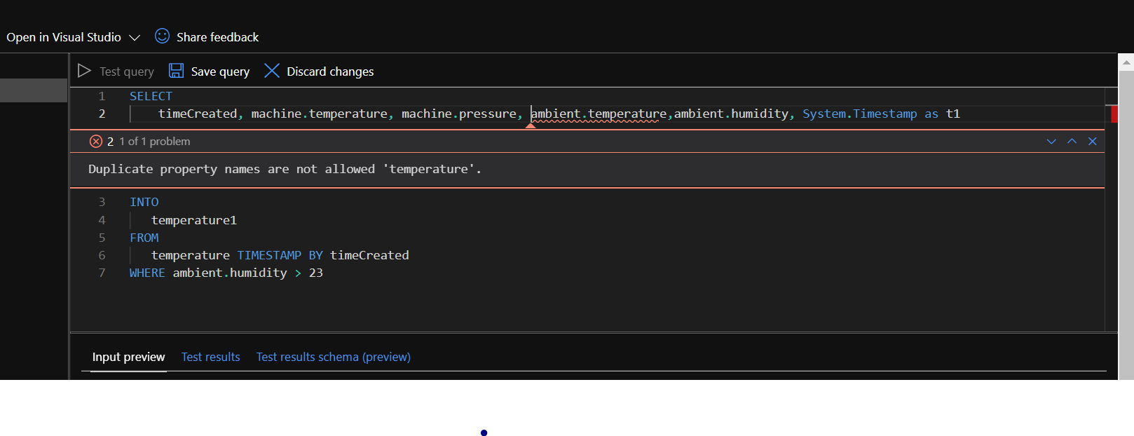

Hello,
I am trying to run the following query, but it shows the error as duplicate property name. However the names are different

  1. Matthijs van der Veer 4,376 Reputation points MVP Volunteer Moderator
    2022-02-18T14:21:03.647+00:00
    I don't have an answer for your second question, maybe you could post that as a separate question. But for your first question:
    If you have properties with the same name (both of yours end with .temperature, so the property will be called temperature, you can give them an alias. Your query could be
    SELECT
      timeCreated,
      machine.temperature AS machineTemperature,
      machine.pressure AS machinePressure,
      ambient.temperature AS ambientTemperature,
      ambient.humidity AS ambientHumidity,
      System.Timestamp as t1
    This will make sure that you don't have duplicate property names.
