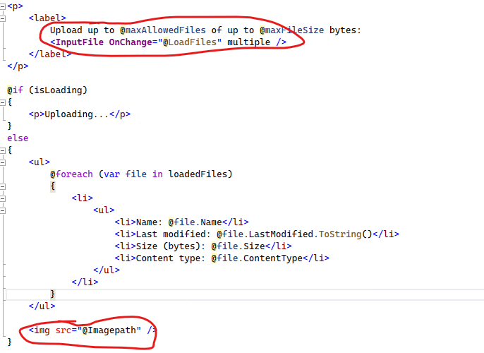

Hello Community,
i want to upload an Image with maximum size of 128Kb in my Blazor Serverside project. I heard that i terms of dataintegrity and security it would be better to save it to db. And since i only have to deal with about 20-30 Images the db would not be overload. I already created a byte[] property in my ef core entity and looked up file upload in blazor docs and found this https://learn.microsoft.com/en-us/aspnet/core/blazor/file-uploads?view=aspnetcore-6.0&pivots=server
There i read that it is not good practice to load the data stream first into a MemoryStream and read byte-array but i don't know i could transfer the bytes into my db entity without haveing it first laying around in my memory (with wouldn't be great for the other websites running on my server). Do you have any ideas for me how to solve this problem?
My Database is a PostgreSQL 12 db on an ubuntu server...

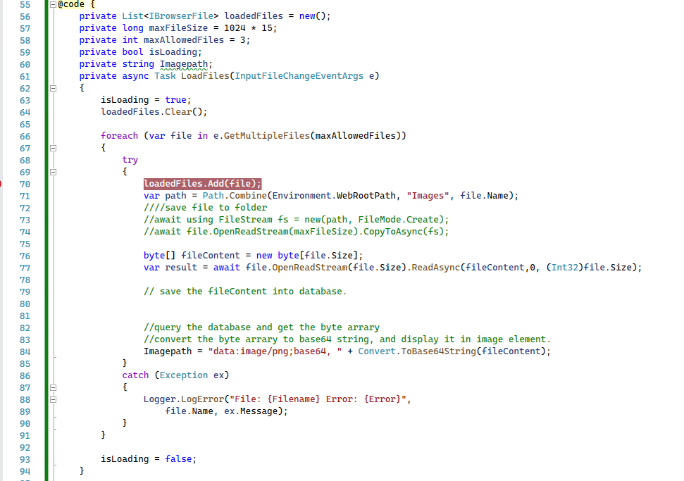

    Hi @Paul ,

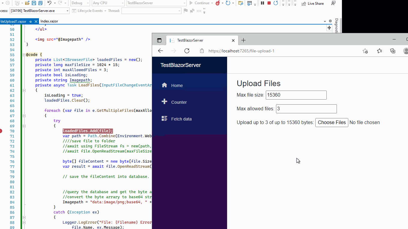

    You can use the Stream.ReadAsync Method asynchronously reads a sequence of bytes from the current stream. Refer to the following sample:
    You can view the source code from here: 176272-blazorfileupload.txt
    The output is like this:
