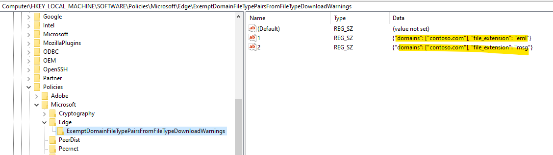

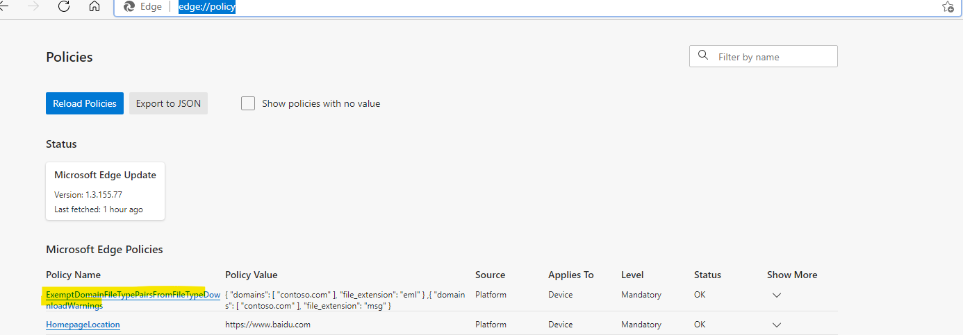

    For this issue, I have done the same test as yours in my lab. Honestly, it doesn't work and it shows error. However, I find there is a setting "Disable download file type extension-based warnings for specified file types on domains" in Administrative Templates profile. It seems the same configuration as the custom profile's.
    When I deploy it, it shows success and the values are added in Registry. So, it is suggested to try to perform it as a workaround.
