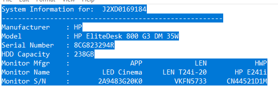

Out put comes as follows
I want the Name and Monitor Year formated correctly

  1. Rich Matheisen 48,116 Reputation points
    2022-02-23T03:41:59.913+00:00
    To put your combination of string data (the row headers) and array contents into columns, and do it in a way that doesn't depend on manually counting the number of tab characters to maintain the column alignment takes a bit of code.

    That will line up the columns no matter what their widths are.
  2. DHoss 61 Reputation points
    2022-02-22T19:24:21.97+00:00
    Thanks for reply. what I meant is that I want them align correctly like Monitor year for the first one is just under the first monitor but the 2nd and 3rd is not. i was looking for way to align them
