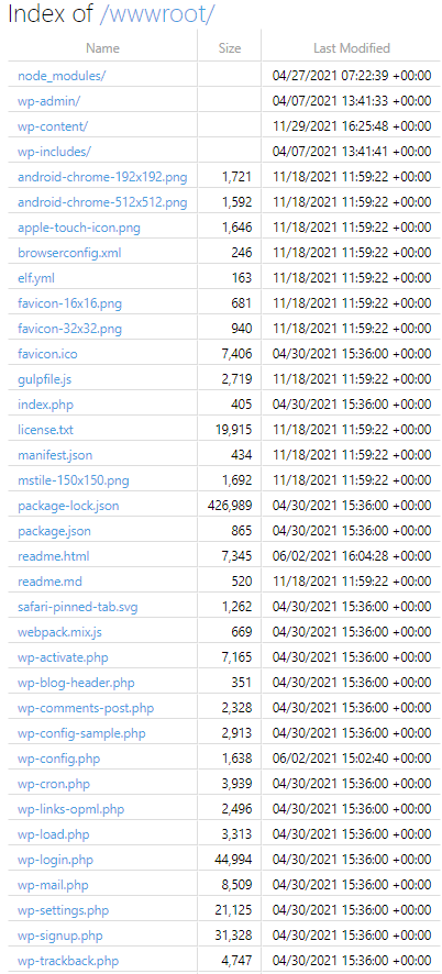

Looking into the contents of wwwroot on the Kudu scm site, all the files for the whole application are there as expected. However, the timestamps for each directory/file in wwwroot show that the new component files I had pushed through GitHub were missing and and changes to the existing files had not been pushed it to the Azure Web app. Some files had the timestamp of a previous deployment that had similar issues to this one, but none have a timestamp for the latest deployment made today 23/02/2022.
