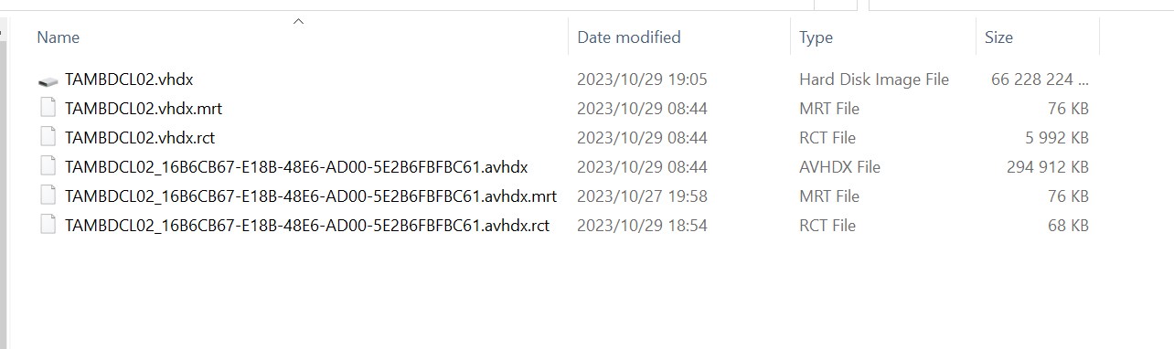

    This work for me with old linux vm gen 1 machines:
    https://bauer207.rssing.com/chan-7520589/article15.html
  2. Sujay Jagadish Desai 1 Reputation point Microsoft Employee
    2022-02-28T09:53:40.113+00:00
    @Ingo D - In some scenarios Hyper-V snapshot merge is failing due to which you might see this error. When the backups are failed, please check if you find unmerged snapshots on the VM. That should confirm the issue. In either case I would suggest connecting with our support team to investigate this further. Also ensure that you have antivirus exclusion configured as documented here - https://learn.microsoft.com/en-us/system-center/dpm/run-antivirus-server?view=sc-dpm-2019
