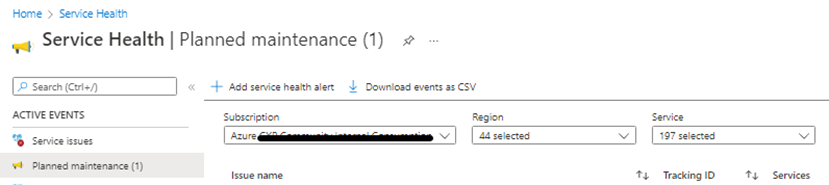

    3. Could you please share the screenshot of the notification you’d received, from the health dashboard?
    Typically, the first notifications will be created about 7 days before an actual upgrade operation starts.
