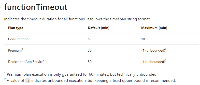

  1. Bruno Lucas 6 Reputation points
    2022-03-04T03:18:56.6+00:00
    Hi, You mentioned "Resource Group and FunctionApp has no ties to any Azure Load Balancers"
    What type of service plan are you using?
    Did you try the FunctionTimeout under the host.json
    "version": "2.0",
    "functionTimeout": "00:10:00",
    "logging": {
    "applicationInsights": {
    "samplingSettings": {
    "isEnabled": true,
    "excludedTypes": "Request"
    This seems to work on the VS emulator but not on real Function Aps. Would be good if Microsoft would clarify that on their documentation. I tried the same code that works on emulator and it failed exact after 230 seconds in both "Consumption" and "Premium"
    I think this forced 230s applies to HTTP Request only. Microsoft Documentation can be confusing for Azure Functions
    if you see this example of the host file, they added all params in one file. I know not all of them apply for every type of trigger but they don't clarify that here:
    https://learn.microsoft.com/en-us/azure/azure-functions/functions-host-json
