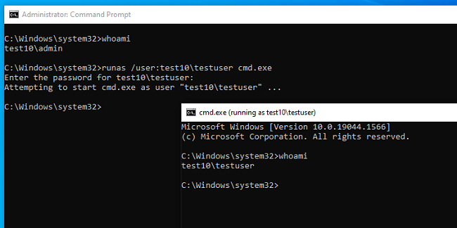

    Let's see if there is some restriction or problem with the account. Open an admin command prompt and use runas to launch a cmd prompt as that user.
    runas /user:DS\ServceCopy cmd.exe
    You will be prompted for the account's password. You can then use whoami.exe to verify what account the process is running under.
