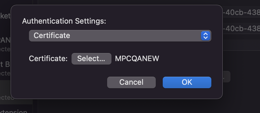

    Also, you could try changing the Authentication Settings to None & select the certificate manually as described below:
    • Click on Authentication Settings to open the Authentication Settings.
    • Set Authentication settings to "none"
    • Select certificate
    • Select your client certificate as you would normally.
    • And try again.
    See the below screenshot for reference:
    Kindly let us know if the above helps or you need further assistance on this issue.
