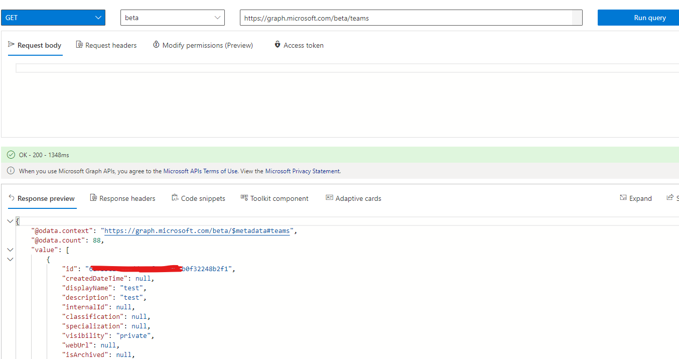

  1. CarlZhao-MSFT 46,376 Reputation points
    2022-03-08T09:22:26.437+00:00
    Hi @Deeptha
    I tested it locally and it doesn't seem to have a problem, can you use the Graph Explorer to call the api test?
    Also, make sure the user you log into Graph Explorer has an O365 license.
