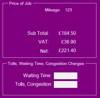

Hi Great People
I am having a issue with adding a value to a value in a Label.
Basically When I select Data from my Database. My Labels are filled with Currency Values. ( LbSubTotal ), ( LbVAT ), ( LbNet )
I also have two textboxes ( TxtWaitingTime ) , ( TxtTolls )
Is what I am trying to achieve is, when I need to enter a value into One or Both of the textboxes, I then want to add the value of the textbox(s) to a Label ( LbNet).
This means I want to add the value of the two textboxes (if any value(s) have been inserted). to the label LbNet.
I have tried Code that was written for me by a great person ( LesHay ) I have tried manipulating LesHay's Code to suit the issue I have. to no Avail.
The Code I have...

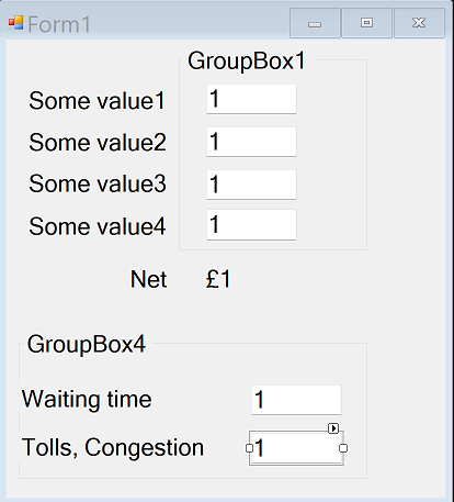

  1. LesHay 7,146 Reputation points
    2022-03-08T19:07:42.74+00:00
    Hi
    Here is an example. Here, use a Label with Net amount (string value), and add both values from 2 textboxes below. However, I suspect that you will not be happy doing this. The values are constantly being added to every time a TextBox changes. I feel you would be better to have a 'Calc' button once values are entered, and, that you repeat the entire calculation - otherwise the point about constant changes will occur (slightly differently)
    Public Class Form1
     Private Sub TextBox1_TextChanged(sender As Object, e As EventArgs) Handles TextBox1.TextChanged, TextBox2.TextChanged
     Dim tot As Decimal = 0.00
     For Each c As Control In GroupBox4.Controls
     If c.GetType = GetType(TextBox) Then
     tot += GetDecimal(c.Text)
     End If
     Next
     Dim labVal As Decimal = GetDecimal(Label2.Text.Replace("£"c, String.Empty))
     Label2.Text = (labVal + tot).ToString("£0.00")
    ' or,  Label2.Text = (labVal + tot).ToString("c2")
     End Sub
     Function GetDecimal(s As String) As Decimal
     Dim v As Decimal = 0.00
     If Decimal.TryParse(s, v) Then Return v
     Return 0.00
     End Function
    End Class

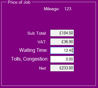

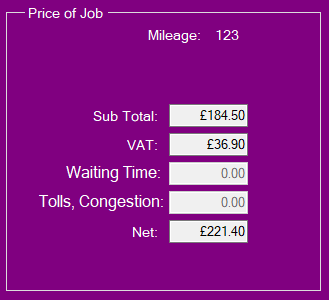

  3. Gary Simpson 471 Reputation points
    2022-03-09T15:54:17.217+00:00
    Hi LesHay
    Thanks again for taking the time and trouble to look at my question and writing out the code.
    I tried your code altering your code to my Textboxes. ( I have exchange Labels for textboxes ) And the sum did not seem to change net value.
    But I have written a simple code for the sum that works now.
    Code I Have now.
    Sub Calc()
            Dim Sum1 As Decimal = GetDec(TxtSubTotal.Text)
            Dim Sum2 As Decimal = GetDec(TxtVAT.Text)
            Dim Sum3 As Decimal = GetDec(TxtWaitingTime.Text)
            Dim Sum4 As Decimal = GetDec(TxtTolls.Text)
            TxtNet.Text = Sum1 + Sum2 + Sum3 + Sum4
            TxtNet.Text = FormatCurrency(TxtNet.Text)
        End Sub
        Private Sub TxtWaitingTime_TextChanged(sender As Object, e As EventArgs) Handles TxtWaitingTime.TextChanged, TxtTolls.TextChanged
            Calc()
        End Sub
            Dim v As Decimal = 0.0D
            Return 0.0D
        End Function
        Private Sub TxtWaitingTime_Leave(sender As Object, e As EventArgs) Handles TxtWaitingTime.Leave
            If String.IsNullOrWhiteSpace(TxtWaitingTime.Text) = True Then
                TxtWaitingTime.Text = "0.00"
            ElseIf String.IsNullOrWhiteSpace(TxtWaitingTime.Text) = False Then
                'do nothing just show value
                TxtWaitingTime.Text = FormatCurrency(TxtWaitingTime.Text)
            End If
        End Sub
        Private Sub TxtTolls_Leave(sender As Object, e As EventArgs) Handles TxtTolls.Leave
            If String.IsNullOrWhiteSpace(TxtTolls.Text) = True Then
                TxtTolls.Text = "0.00"
            ElseIf String.IsNullOrWhiteSpace(TxtTolls.Text) = False Then
                TxtTolls.Text = FormatCurrency(TxtTolls.Text)
            End If
        End Sub
    Kindest Regards
    Gary

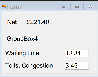

  4. LesHay 7,146 Reputation points
    2022-03-09T16:34:37.283+00:00
    Hi
    Here is a slightly better version, doing away with the Leave event handler altogether. As usual with all the code I post, always needs proper testing and perhaps exception handling as the snippets I post are 'as is' and have limited testing and little or no exception handling.
    This version seems to be OK as far as I have tested. and reduces the code somewhat.
    Option Strict On
    Option Explicit On
    Public Class Form1
        Private Sub Form1_Load(sender As Object, e As EventArgs) Handles MyBase.Load
            TextBox1.Text = FormatCurrency(0)
            TextBox2.Text = FormatCurrency(0)
            TextBox3.Text = FormatCurrency(1.45)
            TextBox4.Text = FormatCurrency(2.55)
            TextBox5.Text = FormatCurrency(3.55)
            TextBox6.Text = FormatCurrency(4.45)
            Calc()
        End Sub
        Sub Calc()
            Dim tot As Decimal = 0.0D
            For Each gbc As Control In Controls
                If gbc.GetType = GetType(GroupBox) Then
                    For Each c As Control In gbc.Controls
                            tot += GetDecimal(c.Text.Replace("£"c, String.Empty))
                            AddHandler c.TextChanged, AddressOf TextBox_TextChanged
                        End If
                    Next
                End If
            Next
            Label2.Text = FormatCurrency(tot)
        End Sub
        Private Sub TextBox_TextChanged(sender As Object, e As EventArgs)
            Dim c As TextBox = DirectCast(sender, TextBox)
            Dim pos As Integer = c.SelectionStart
            Dim len As Integer = c.SelectionLength
            c.Text = FormatCurrency(GetDecimal(c.Text.Replace("£"c, String.Empty)))
            c.SelectionStart = pos
            c.SelectionLength = len
            Calc()
        End Sub
            Return 0.0D
        End Function
    End Class
