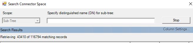

Whats the best way to do a data verification between the AAD connect staging server and AAD production server?
Reason I ask is
When I select the domain, and cllick search connector space and run. The old server results are 116794 and new server is 116662. I need help figuring out what the 132 missing records are. I double checked the containers objects for AD, comparing the servers. 181171-capture.jpg

    You could use csexport and CSExportAnalyzer tools from Azure AD connect which helps you to retrieve all changes that are about to be exported in the export.csv file by using which you can inspect changes in staging server also you find out missing records. To learn more about, refer : https://learn.microsoft.com/en-us/azure/active-directory/hybrid/how-to-connect-sync-staging-server#verify .
