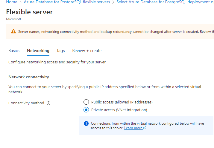

In the page also, it was shown to create a separate vm in the same vnet to connect to postgres setup in a private vnet option selected.
https://learn.microsoft.com/en-us/azure/postgresql/flexible-server/quickstart-create-connect-server-vnet
Is there anyway to connect using azure bastion.please show the steps.
