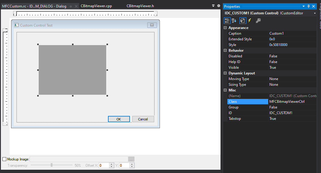

    I successfully created a VS2019 project with the custom bitmap viewer control from the CodeProject article.
    VS2019 Dialog Editor -
    .RC file -
        CONTROL         "Custom1",IDC_CUSTOM1,"MFCBitmapViewerCtrl",WS_BORDER | WS_TABSTOP,56,34,150,102

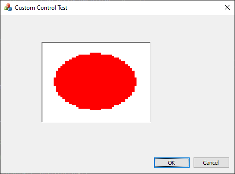

    Execution with ugly bitmap -
