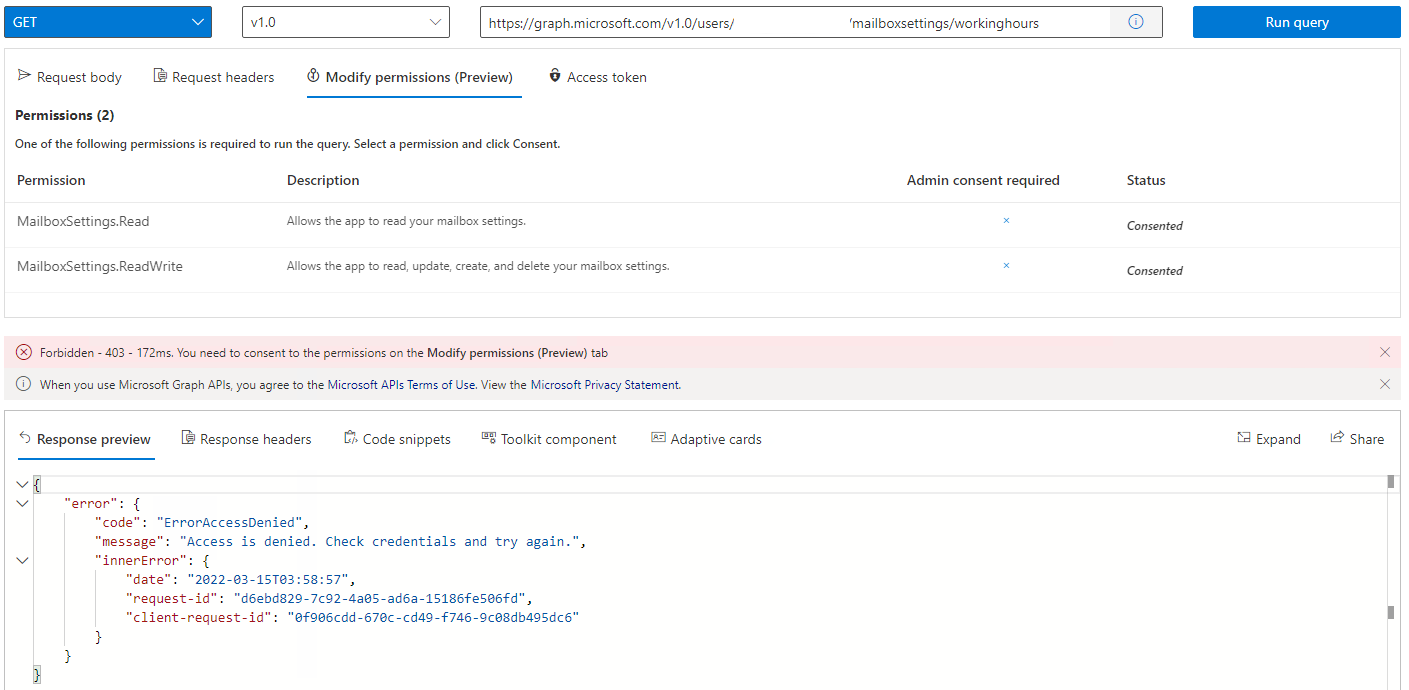

I am trying to get WorkingHours from Mailbox settings for my users. I have set the API permissions in Azure, and in Graph Explorer and if I run the below query with my email address it works fine. But as soon as I change the email address to one of my users it errors as per the screenshot. Both Azure and Explorer say I've consented so I'm a bit bemused.
https://graph.microsoft.com/v1.0/users/blah[@](/users/na/?userId=90ae04c7-7ffe-0003-0000-000000000000).com.au/mailboxsettings/workinghours

    Graph Explorer does not support calling the /users/{user id} endpoint, you can only use it to call the /me endpoint: me/mailboxsettings/workinghours.

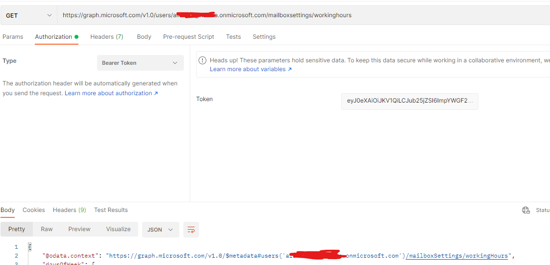

    The /users/{user id} endpoint is usually adapted to the application context, so you should grant your application the MailboxSettings.Read application permission in Azure AD, then use the client credentials flow to get the token and call the /users/{id|userPrincipalName}/mailboxsettings/workinghours api endpoint in postman.
