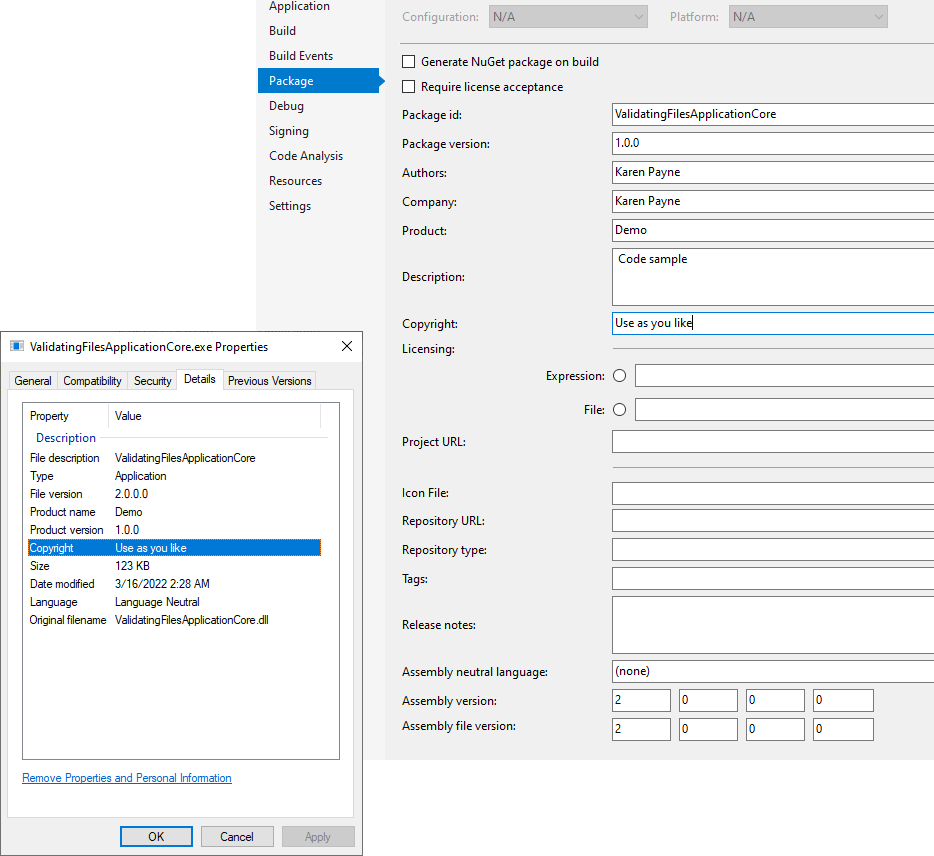

  1. Karen Payne MVP 35,586 Reputation points Volunteer Moderator
    2022-03-16T09:30:58.52+00:00
    These are under Package Tab.
    Note the information is stored in each project file e.g.
    <Project Sdk="Microsoft.NET.Sdk">
     <PropertyGroup>
     <AssemblyVersion>2.0.0.0</AssemblyVersion>
     <FileVersion>2.0.0.0</FileVersion>
     <Authors>Karen Payne</Authors>
     <Product>Demo</Product>
     <Description>Code sample</Description>
     <Copyright>Use as you like</Copyright>
     </PropertyGroup>
    Get App Version in .NET Core
